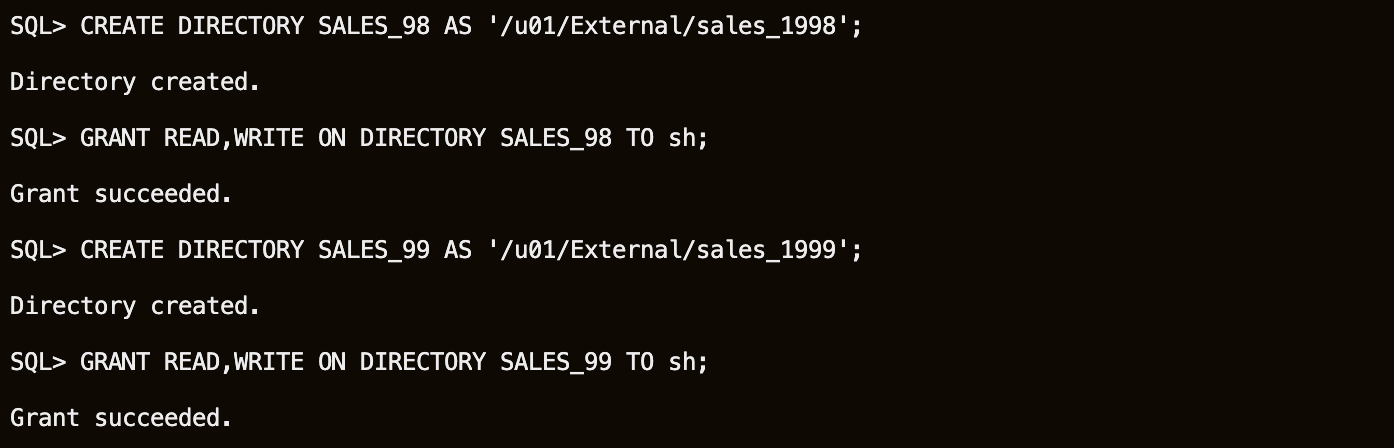

  6. Create two external directories and grant access to the SH user.
    CREATE DIRECTORY SALES_98 AS '/u01/External/sales_1998';
    GRANT READ,WRITE ON DIRECTORY SALES_98 TO sh;
    CREATE DIRECTORY SALES_99 AS '/u01/External/sales_1999';
    GRANT READ,WRITE ON DIRECTORY SALES_99 TO sh;
    directory objects

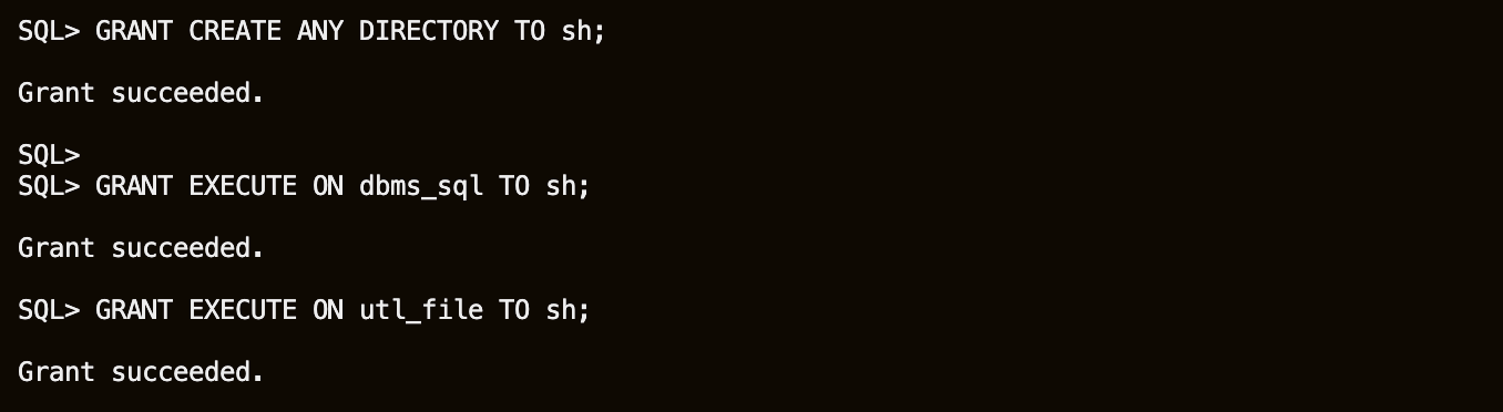

  7. Grant additional privileges to SH user.
    GRANT CREATE ANY DIRECTORY TO sh;
    GRANT EXECUTE ON dbms_sql TO sh;
    GRANT EXECUTE ON utl_file TO sh;
    grant privileges
    The DBMS_SQL package provides an interface to use dynamic SQL to parse any data manipulation language (DML) or data definition language (DDL) statement using PL/SQL. Using the UTL_FILE package, PL/SQL programs can read and write operating system text files. UTL_FILE provides a restricted version of the operating system stream file I/O. One use case is for exporting data into flat files, that will become external partitions.

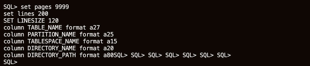

  1. Login to the pdb as the SH user and set some formatting for SQL*Plus output.
    sqlplus sh/Ora_DB4U@localhost:1521/orclpdb
    set pages 9999
    set lines 200
      SET LINESIZE 120
    column TABLE_NAME format a27
    column PARTITION_NAME format a25
    column TABLESPACE_NAME format a15
    column DIRECTORY_NAME format a20
    column DIRECTORY_PATH format a80
    format output

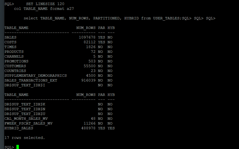

  2. Examine the Sales History schema.
    --QUERY
    select TABLE_NAME, NUM_ROWS, PARTITIONED, HYBRID from USER_TABLES ORDER BY TABLE_NAME;
    examine schema
    Table SALES is partitioned and does not use hybrid partitioning. We will use this table as an example, to see how hybrid partitioning works.

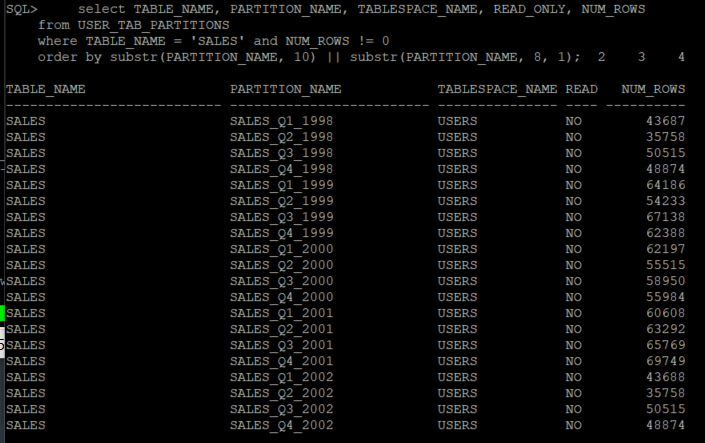

    There are 5 years of data in the SALES table: 1998, 1999, 2000, 2001, 2002. The data is partitioned in yearly quarters. (Note that the 2003 partitions exist but are empty)
    column name format a30
    column owner format a20
    --QUERY
    select TABLE_NAME, PARTITION_NAME, TABLESPACE_NAME, READ_ONLY, NUM_ROWS
    from USER_TAB_PARTITIONS
    where TABLE_NAME = 'SALES' and NUM_ROWS != 0
    order by substr(PARTITION_NAME, 10) || substr(PARTITION_NAME, 8, 1);

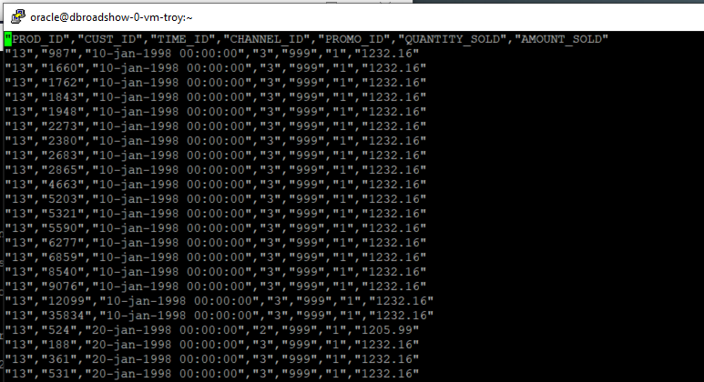

  4. Open another terminal window into your environment (Duplicate Putty session for example) and examine the CSV file. The following example uses vim, but any editor will suffice.
    vim /u01/External/sales_1998/SALES_Q1_1998.csv
    edit csv file

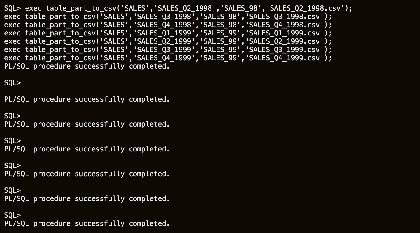

  5. The first line of the file contains the names of the columns. All data fields are enclosed within double quotes and fields are separated by a comma. This format can be customized. For this lab session, we will use this same format for the rest of the SALES table partitions that store data for the years 1998 and 1999.
    exec table_part_to_csv('SALES','SALES_Q2_1998','SALES_98','SALES_Q2_1998.csv');
      exec table_part_to_csv('SALES','SALES_Q3_1998','SALES_98','SALES_Q3_1998.csv');
    exec table_part_to_csv('SALES','SALES_Q4_1998','SALES_98','SALES_Q4_1998.csv');
    exec table_part_to_csv('SALES','SALES_Q1_1999','SALES_99','SALES_Q1_1999.csv');
    exec table_part_to_csv('SALES','SALES_Q2_1999','SALES_99','SALES_Q2_1999.csv');
    exec table_part_to_csv('SALES','SALES_Q3_1999','SALES_99','SALES_Q3_1999.csv');
    exec table_part_to_csv('SALES','SALES_Q4_1999','SALES_99','SALES_Q4_1999.csv');
    export all partitions

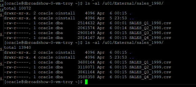

  6. In the other opened terminal window, ensure all partitions were exported.
    ls -alh /u01/External/sales_1998/
      ls -alh /u01/External/sales_1999/
    show files

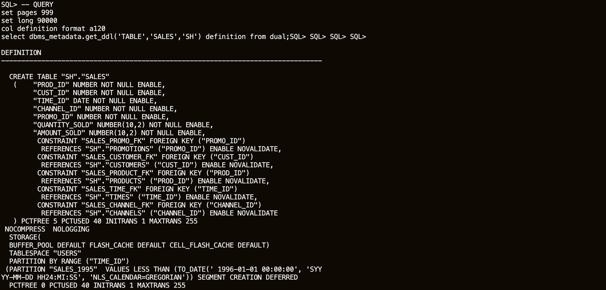

  1. As you will copy SALES, retrieve the DDL script from the database.
    set pages 999
    set long 90000
    col definition format a120
      -- QUERY
      select dbms_metadata.get_ddl('TABLE','SALES','SH') definition from dual;
    retrieve ddl
    retrieve ddl
    You can edit the CREATE TABLE statement to create a TABLE named HYBRID_SALES where the partitions containing data from 1998 and 1999 reference the CSV files created previously. Or just use the example below. Note that the DDL retrieved from the database cannot be run directly to create a hybrid partitioned table; you must remove all Foreign Keys from the original statement, because of the restrictions on Hybrid Partitioned Tables, only RELY constraints are allowed.
    The hybrid range-partitioned table is created with eight external partitions and sixteen internal partitions. You can specify for each external partition different attributes than the default attributes defined at the table level, DIRECTORY for example.
    Range partitioning maps data to partitions based on ranges of values of the partitioning key that you establish for each partition. Range partitioning is the most common type of partitioning and is often used with dates. For a table with a date column as the partitioning key, a partition named January-2017, for example, would contain rows with partitioning key values from 01-Jan-2017 to 31-Jan-2017.
    Each partition has a VALUES LESS THAN clause, that specifies a non-inclusive upper bound for the partitions. Any values of the partitioning key equal to or higher than this literal are added to the next higher partition. All partitions, except the first, have an implicit lower bound specified by the VALUES LESS THAN clause of the previous partition.

     PARTITION "SALES_Q1_2000"  VALUES LESS THAN
      (TO_DATE(' 2000-04-01 00:00:00', 'SYYYY-MM-DD HH24:MI:SS', 'NLS_CALENDAR=GREGORIAN'))
      SEGMENT CREATION IMMEDIATE
      PCTFREE 0 PCTUSED 40 INITRANS 1 MAXTRANS 255
      COMPRESS BASIC NOLOGGING
      STORAGE(INITIAL 8388608 NEXT 1048576 MINEXTENTS 1 MAXEXTENTS 2147483645
      PCTINCREASE 0 FREELISTS 1 FREELIST GROUPS 1)
      TABLESPACE "USERS" ,
     PARTITION "SALES_Q2_2000"  VALUES LESS THAN
      (TO_DATE(' 2000-07-01 00:00:00', 'SYYYY-MM-DD HH24:MI:SS', 'NLS_CALENDAR=GREGORIAN'))
     PARTITION "SALES_Q3_2000"  VALUES LESS THAN
      (TO_DATE(' 2000-10-01 00:00:00', 'SYYYY-MM-DD HH24:MI:SS', 'NLS_CALENDAR=GREGORIAN'))
     PARTITION "SALES_Q4_2000"  VALUES LESS THAN
      (TO_DATE(' 2001-01-01 00:00:00', 'SYYYY-MM-DD HH24:MI:SS', 'NLS_CALENDAR=GREGORIAN'))
     PARTITION "SALES_Q1_2001"  VALUES LESS THAN
      (TO_DATE(' 2001-04-01 00:00:00', 'SYYYY-MM-DD HH24:MI:SS', 'NLS_CALENDAR=GREGORIAN'))
     PARTITION "SALES_Q2_2001"  VALUES LESS THAN
      (TO_DATE(' 2001-07-01 00:00:00', 'SYYYY-MM-DD HH24:MI:SS', 'NLS_CALENDAR=GREGORIAN'))
     PARTITION "SALES_Q3_2001"  VALUES LESS THAN
      (TO_DATE(' 2001-10-01 00:00:00', 'SYYYY-MM-DD HH24:MI:SS', 'NLS_CALENDAR=GREGORIAN'))
     PARTITION "SALES_Q4_2001"  VALUES LESS THAN
      (TO_DATE(' 2002-01-01 00:00:00', 'SYYYY-MM-DD HH24:MI:SS', 'NLS_CALENDAR=GREGORIAN'))
     PARTITION "SALES_Q1_2002"  VALUES LESS THAN
      (TO_DATE(' 2002-04-01 00:00:00', 'SYYYY-MM-DD HH24:MI:SS', 'NLS_CALENDAR=GREGORIAN'))
     PARTITION "SALES_Q2_2002"  VALUES LESS THAN
      (TO_DATE(' 2002-07-01 00:00:00', 'SYYYY-MM-DD HH24:MI:SS', 'NLS_CALENDAR=GREGORIAN'))
     PARTITION "SALES_Q3_2002"  VALUES LESS THAN
     (TO_DATE(' 2002-10-01 00:00:00', 'SYYYY-MM-DD HH24:MI:SS', 'NLS_CALENDAR=GREGORIAN'))
     PARTITION "SALES_Q4_2002"  VALUES LESS THAN
     (TO_DATE(' 2003-01-01 00:00:00', 'SYYYY-MM-DD HH24:MI:SS', 'NLS_CALENDAR=GREGORIAN'))
     PARTITION "SALES_Q1_2003"  VALUES LESS THAN
      (TO_DATE(' 2003-04-01 00:00:00', 'SYYYY-MM-DD HH24:MI:SS', 'NLS_CALENDAR=GREGORIAN'))
     PARTITION "SALES_Q2_2003"  VALUES LESS THAN
      (TO_DATE(' 2003-07-01 00:00:00', 'SYYYY-MM-DD HH24:MI:SS', 'NLS_CALENDAR=GREGORIAN'))
      SEGMENT CREATION DEFERRED
     PARTITION "SALES_Q3_2003"  VALUES LESS THAN
      (TO_DATE(' 2003-10-01 00:00:00', 'SYYYY-MM-DD HH24:MI:SS', 'NLS_CALENDAR=GREGORIAN'))  SEGMENT CREATION DEFERRED
     PARTITION "SALES_Q4_2003"  VALUES LESS THAN
      (TO_DATE(' 2004-01-01 00:00:00', 'SYYYY-MM-DD HH24:MI:SS', 'NLS_CALENDAR=GREGORIAN'))
      PCTFREE 5 PCTUSED 40 INITRANS 1 MAXTRANS 255
      NOCOMPRESS NOLOGGING
      TABLESPACE "USERS" );

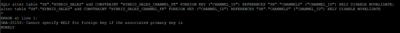

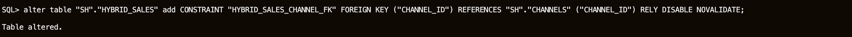

  2. Add Foreign Key constraints.
    Foreign Key constraints are constantly validated for all data coming into the SALES table. Using RELY constraints, it means that you can trust the original SALES table to provide clean data, instead of implementing constraints in the HYBRID_SALES table used for reporting.
    RELY constraints, even though they are not used for data validation, can enable more sophisticated query rewrites for materialized views, or enable other data warehousing tools to retrieve information regarding constraints directly from the Oracle data dictionary. Creating a RELY constraint is inexpensive and does not impose any overhead during DML or load. Because the constraint is not being validated, no data processing is necessary to create it.
    alter table "SH"."HYBRID_SALES" add CONSTRAINT "HYBRID_SALES_CHANNEL_FK" FOREIGN KEY ("CHANNEL_ID") REFERENCES "SH"."CHANNELS" ("CHANNEL_ID") RELY DISABLE NOVALIDATE;

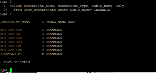

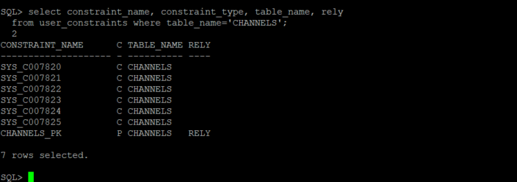

  3. This statement assumes that the Primary Key is in the RELY state. If you get the following error.
    rely state
    Check the constraints associated with the CHANNELS table.
    select constraint_name, constraint_type, table_name, rely
        from user_constraints where table_name='CHANNELS';
    check constraints

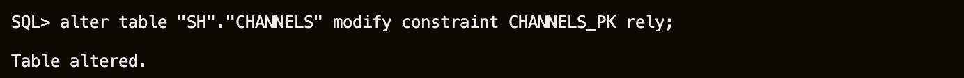

  4. Place the CHANNELS_PK constraint in RELY state.
    alter table "SH"."CHANNELS" modify constraint CHANNELS_PK rely;
    fix constraint
  5. Confirm the constraint state.
    confirm constraint
  6. Add the RELY Foreign Key constraint on the HYBRID_SALES table.
    foreign key
    Additional foreign key constraints from the original SALES table could be added to the HYBRID_SALES table using the same methodology.

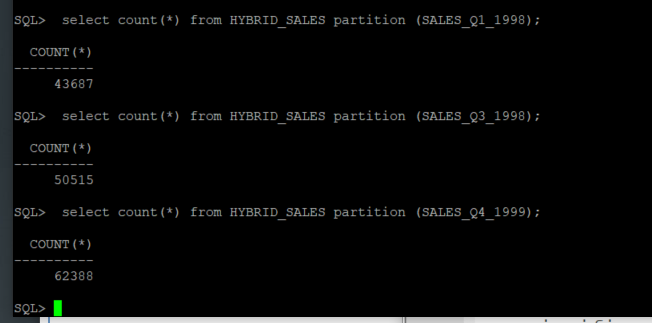

  1. The first thing to notice is that data is already stored in the external partitions.
    --QUERY
      select count(*) from HYBRID_SALES partition (SALES_Q1_1998);
    select count(*) from HYBRID_SALES partition (SALES_Q3_1998);
    select count(*) from HYBRID_SALES partition (SALES_Q4_1999);
    select from external partitions

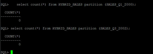

  2. But there is no data in the internal partitions.
    --QUERY
      select count(*) from HYBRID_SALES partition (SALES_Q1_2000);
    select count(*) from HYBRID_SALES partition (SALES_Q3_2002);
    no data

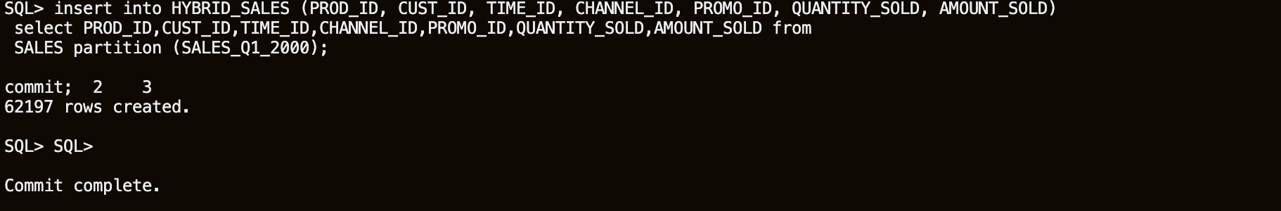

  3. You can insert rows into internal partitions from the original SALES table. Using the partition extension clause PARTITION (partition_name), we can specify the name of the partition within the SALES table from which we want to retrieve data, in order to populate a given internal partition.
    insert into HYBRID_SALES (PROD_ID, CUST_ID, TIME_ID, CHANNEL_ID, PROMO_ID, QUANTITY_SOLD, AMOUNT_SOLD)
     select PROD_ID,CUST_ID,TIME_ID,CHANNEL_ID,PROMO_ID,QUANTITY_SOLD,AMOUNT_SOLD from
      commit;
    insert rows
  4. Confirm the data was added.
    check data

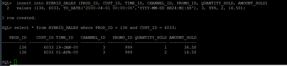

  5. Insert records into the new table. Verify individual records in the HYBRID_SALES table, filtering on PROD_ID (product id) and CUST_ID (customer id).
    select * from HYBRID_SALES where PROD_ID = 136 and CUST_ID = 6033;
    individual records
  6. Insert data into the new table. Notice that this will insert into an internal partition.
    values (136, 6033, TO_DATE('2000-02-01 00:00:00', 'YYYY-MM-DD HH24:MI:SS'), 3, 999, 2, 16.58);
    commit;
    insert record

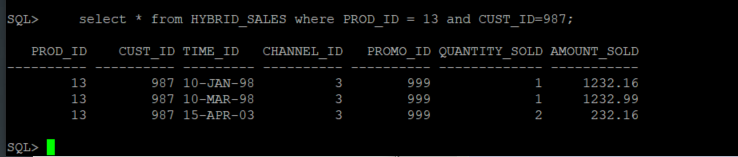

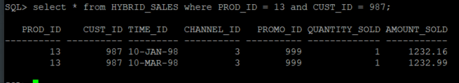

  7. We can also read data from an external partition.
    select * from HYBRID_SALES where PROD_ID = 13 and CUST_ID = 987;
    read record

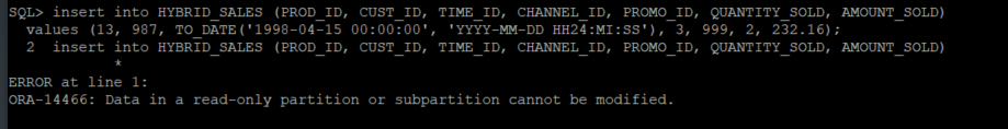

  8. However, if we try to insert or update data in an external partition, we get an error. Data in external partitions cannot be modified using traditional commands, it is as if we have specified the READ ONLY clause at the partition level in the CREATE TABLE statement.
     values (13, 987, TO_DATE('1998-04-15 00:00:00', 'YYYY-MM-DD HH24:MI:SS'), 3, 999, 2, 232.16);
    insert into external partition
  9. An ALTER TABLE statement can not enable read-write mode on an external partition.
    alter table HYBRID_SALES modify partition SALES_Q2_1998 read write;
    insert error

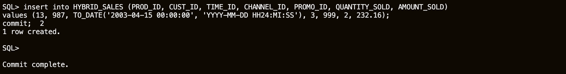

  10. Only data in internal partitions can be updated or inserted.
    values (13, 987, TO_DATE('2003-04-15 00:00:00', 'YYYY-MM-DD HH24:MI:SS'), 3, 999, 2, 232.16);
    commit;
    internal data updated
  11. While queries can read and join data from both internal and external partitions.
    query all data

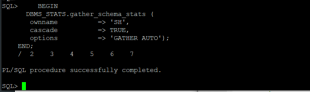

Task 6: Gathering Statistics
  1. Gathering schema statistics for schemas with Hybrid Partitioned Tables is performed in the same way as usual.
    BEGIN
      DBMS_STATS.gather_schema_stats (
       ownname          => 'SH',
       cascade          => TRUE,
       options          => 'GATHER AUTO');
    END;
    gather statistics
  2. Verify the tables in SALES HISTORY schema: the number of rows, partitioned or not, and if partitioned are they using Hybrid Partitioning.
    SET LINESIZE 120
    col TABLE_NAME format a27
      select TABLE_NAME, NUM_ROWS, PARTITIONED, HYBRID from USER_TABLES;
    verify table
